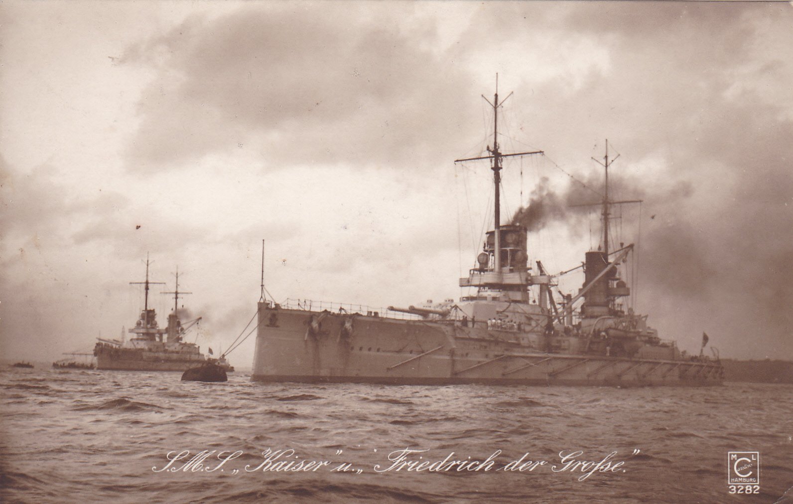

SMS Kaiser, the lead ship of the Kaiser class of battleships with her sistership SMS Friedrich der Große in Norway, early August 1913.jpg
SMS Kaiser a SMS Friedrich der Große v Norsku srpen 1913

Elegantní loď. Asi ty komíny a délka.

Jj, elegantí bezesporu ano.
