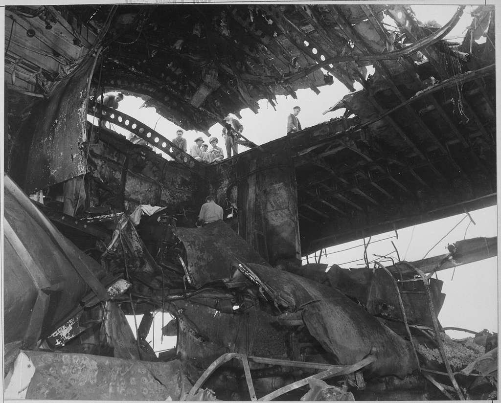

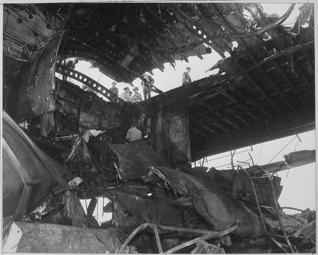

takhle to na tom Randolphu vypadalo po tom zásahu:
damaged-uss-randolph-resulting-from-a-japanese-suicide-attack-damage-to-overhead-6c1df7-1024.jpg
